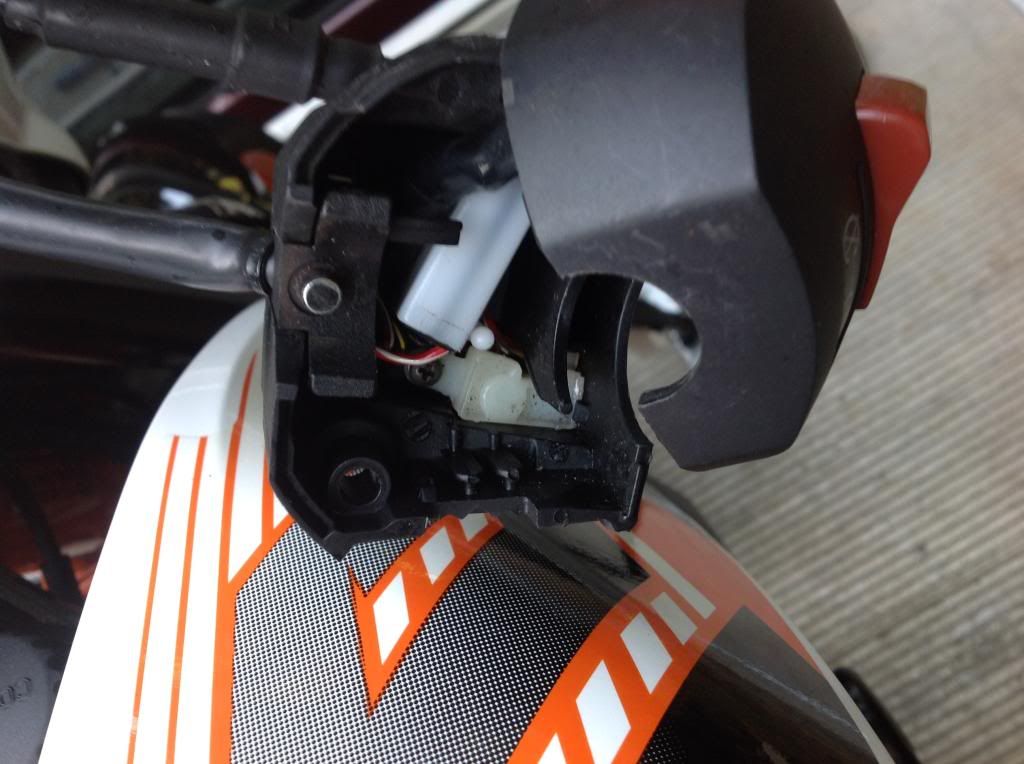

Hi all
Had an issue with the Duke lastnight and left me stranded, starter button ceased to work at all. I had to ute it home and checked it this morning, the starter switch is cheap crap and had the smallest amount of crap in betweem the 2 contact points. After a shot of WD40 it worked again, so if your starter is causing issues this will be the problem.
Didnt get a pic of underneath the white cap but if you unscrew the little one in the pic then get a small flat screwdriver it will just pop up. Blow it out and spray, I will be sealing mine up with Belray Waterproof Grease in all the gaps to stop this happening again.
