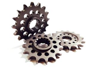

Can anyone provide a link to purchase 16T front sprocket for the 390 in USA?
same products, different source. if it helps.

You can order these from Super Sprox.
I think I'll get a Duke 200 chain sprocket kit (14/42) and replace the front sprocket with one from a 390 - which coincidentally I have a brand new one. It will end up only slightly more expensive than the 16T front sprocket alone hehe
We dont get just sprockets or chains. It's always a set of 2 sprockets and the suitable chain. The front sprocket is an exception though and I managed to get a new one (15T) from KTM service center. Just the new 15T front sprocket was ~3.5USD, new chain and sprocket kit with x ring chain here is about 30USD
Nothing, I guess. The Duke 200 has 110 links instead of 112 for the 390, thats because of the smaller sprockets too I reckon. Using a 42 in place of 45 with the standard chain might stretch it out too much
It worked fine when I used a 15/42 but ultimately I much preferred 16/42.
