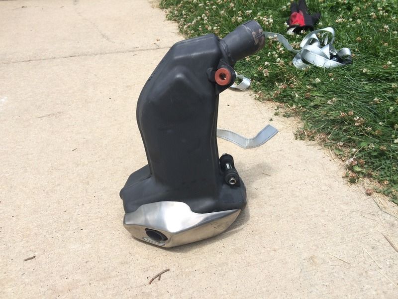

In anticipation of my Werkes exhaust, Bazzaz, air box and quick throttle (Thanks HR and MNNTHX), I figured I'd tackle this "pig of a job"
At first, it did appear to be just that.
Undo all the mounting bolts, nothing moves. Eventually it walked back a tiny bit, but not enough to clear the header.
Header bolt obscured by radiator. So, drop the radiator. Not all the way, but enough to get in there with an extension.
Header removed, the pig came back and then hit the lower engine casing and the swing arm.
It seemed stuck on something. Upon closer inspection, the main through bolt on the bottom, sits in a sleeve, that was a very tight fit between the mounts.
Using 2 12" extensions, I drove that sleeve down enough it cleared one side of the mounts.
Pig was now stuck on the swing arm.
Time for a drink....
Looking at it carefully, I figured that if I compressed the suspension, I might gain enough to force it out.
I ran a ratchet strap over the tail, and hooked into under the swing arm. I cranked it down as hard as it would compress, but not enough. I recon that the strap was too far forward to get enough leverage.
So, I took it off the pit stand, and on side stand, used my spools to hook the ratchet into.
HOLD ON TO THE BIKE........
As I was cranking it down, the bike tried to tip over to the right. Caught it.
Running the strap up over the grab handles, I was able to get it tight enough, until....DONK, it just fell out on it's own.
This sucker weighs 13lbs. Good riddance. I'll post the install of the Werkes system next weekend.
Hope this helps guys
